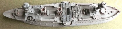

The model is from Thingiverse, supplied in 1/700 scale by 'PC_Model_Yard ' I've scaled it up to 1/350, and have printed most of the bits out - dry fitted together.............
As you can see I've had filament changes - most parts were done on the Anet A5 printer, the turrets on the Monoprice Mini V2. The hul halves took about 6 hours to print out each. I've still to successfully print the cranes, I've had several failures, but they'd be easy enough to scratchbuild, but the latet attempt is looking good.
It's only a small model, and the material cost I reckon will be <£5. The time taken to print out the bits will be longer than the assembly. It will be glued with CA. There aren't any boats in the files, but Thingiverse has a folder with loads of styles of ships' boats that will be scaled to suit. I do have 1/350 PE railings - I'll see how assembly goes before committing to those!
The dry assembled primed bits - and it does look a lot better than all the multi-coloured raw printed parts!

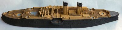

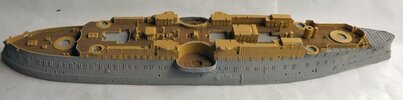

It didn't last long! I've started painting the deck, and then need to paint parts of the superstructure, before adding the boat racks...............

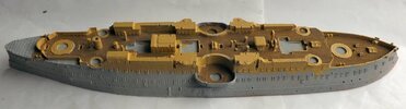

An hour or so of paint therapy....................
I'll need to carefully mask, before I can add the black to the lower hull. Colours: Deck - Old Wood, Superstructure - Buff, both Vallejo Model Color
The masking was a bit of a pig, but after several touch ups, I'm happy

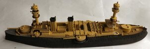

I'm going to have to fit the forward two twin turrets next, as you can't squeeze them in when the forward superstructure is fitted - I'm going to have to consider how many boats will be fitted - quite a lot!
All the major parts are added................
You may note that one of the twin turrets is missing - I dropped it & put my size 11 on it! I can print another out, when I'm doing the boats - no problems with spare parts!
