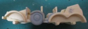

So, I've made a start. A lot of cutting, drilling, filing, and that's just the easy bit!
Things can only go downhill from here!
So, with everything carved off and partly filled, on with the spare wheels
First, new side panels to the front seats
On with the wheels
Rear mudguards extra front panel added, then the spares mudguards added from Apoxie putty
Just a little sanding clean-up needed next, then the small extra outward extensions to the rear mudguards to add
Then time to finish re-shaping the body rear

Right, the extra rear mudguard panels are on and the back end rear-shaping, including the tilt cover, is completed
Next up is adding all the small details: windscreen, wing mirrors, stand lights, steering wheel, gear stick and handbrake, licence plate and towing hook
Plus, the two huge hooks that stick out the front
Well, the build is officially complete! All body re-shaping done and small details added
The wheels will be glued on after painting. Which won't be done until I've practiced the camo schemes with my airbrush a bit more. Thinking I might add a driver figure later too
