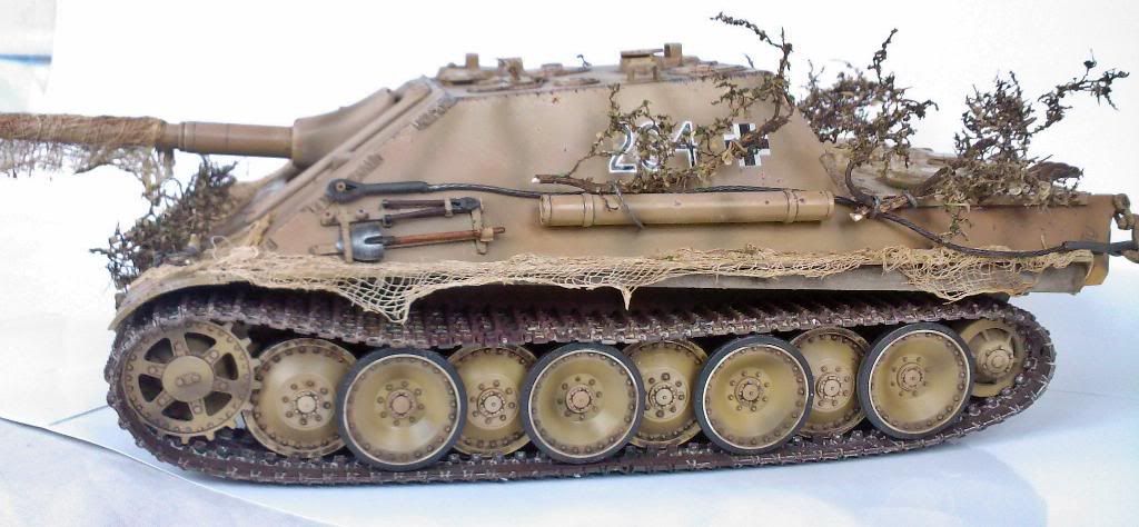

Alan, I think it's way too fiddly to try and paint tracks that are on a model. Some people manage it, but I'd end up getting paint on the wheels etc.
So I prime & paint them prior to fitting. On one occasion I've had a bit of cracking - my Academy 1/25 Jagdpanther springs to mind!  >:(
But in that example, it was easy enough to dab a bit of paint here & there to cover up the missing bits.
You can see that they turned out ok
Of the other rubber band tracks I've used from Tamiya & Dragon, there's never been a problem that I can recall.
