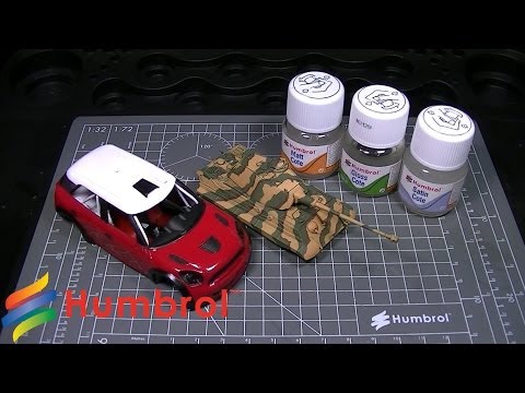

                      Good video here from Humbrol if it is of any use to you:

                        Thank you for sharing the video with me, it was very helpful. I ordered all three types of clear cote and they should arrive soon. What do you use to clean the clear coat out of the airbrush?

                          Treat it like any enamel paint, I use thinner or white spirit. Apparently you can use cellulose thinner as well but I haven't ever used it.
