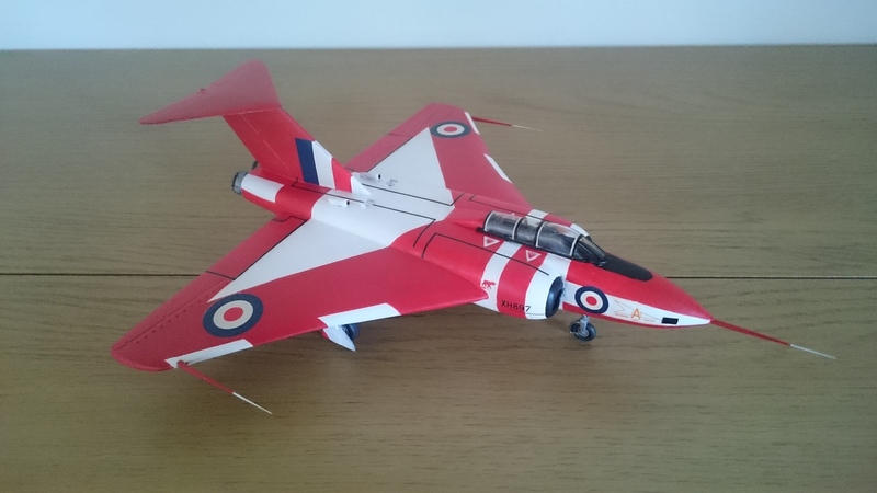

The plastic has a weird look to it although the texture is fine, I have experience with 'ZTS Plastyk' of Poland having built their ultra challenging Gloster Javelin FAW 7/9
