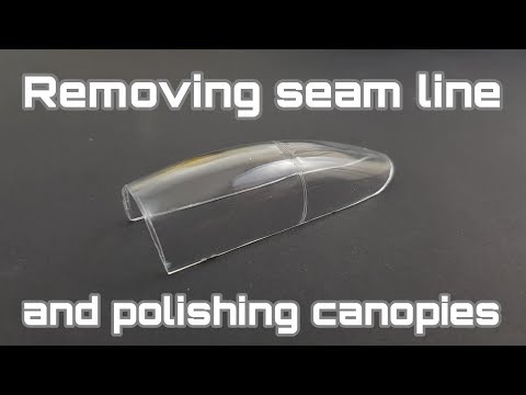

      I have never had to use any compounds for canopies. I sand them off with a fine sanding stick, then follow up with a 1000, then 2000 polishing pad. If need be I finish with 4000 and then a dip in the old Johnson clear.
      It's a good idea to pack the canopy out with plasticine or the like. Follow the profile alternating both along and across the canopy.

        This is what I did with my Tamiya F-16 canopy.. came out perfectly..

          As above for the canopy.
          One of my previous jobs sometimes had me polishing aircraft transparencies. I remember the training video polishing back and forth with one grade abrasive then changing grade abrasive and the direction of polish, this time a right angle and so on until finished.
          Or just watch this video -

                            Couldn’t put this off any longer, the canopy mould line. New blade in the knife, new sanding stick and off I went. I don’t know why I was so worried, ten minutes work and done. Time for paint now as most of the build is finished.

                              And a mighty fine job you've done there Mick!!! Never know it was there.............

                                Nicely done Mick. Just had a catch-up. That's coming on nicely.
