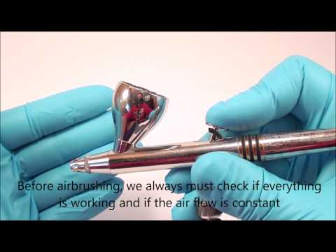

      One good lesson I learned is to add a small drop of thinner into the paint cup fir a dry run. This loosens any tiny left over dried paint residue and to see if the flow is good.

                  When I've cleaned my airbrush I put a few drops of isopropyl alcohol in the cup and press the trigger to check that there is no bubbling, I then leave the alcohol in the airbrush until it's next needed, when a quick blow-through will blast any remnants of paint out.
                    That's a great advice, Pete. Thanks!!!!!
                    stillp But if I leave it for a few days it will be OK?

                      Yes, put the cover on the cup and it should last for a week or more.
