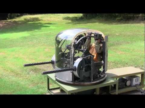

                        I assume on the real aircraft turret, the perspex would be all one piece or at least the part in question would have no seam>
                        Any aberration in the clear perspex would cause the gunner a right nightmare if targets crossed that line, possible causing the target to appear offset.
                          #72
                          One big, curved piece for the top and front:
                          • Waspie
                            • Mar 2023
                            • 3488
                            #73
                            That would be one expensive piece of perspex!!!
