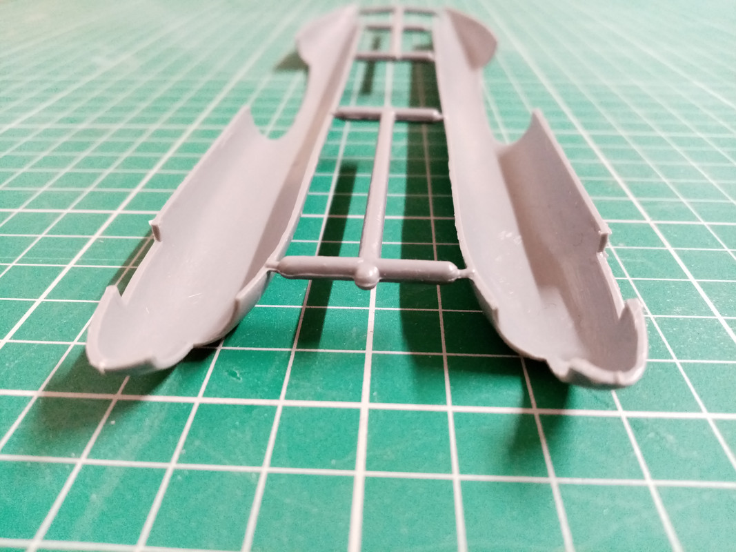

    This one is pretty much what I expected, some lovely flash to clean up to begin with, typical of short run kits there are no locating pins or tabs and slots to assist in assembly, it's mostly pretty fine recessed panels lines with a few 'anomalies' showing this mold has had a busy life!

          Technical problem number 1, the sprue gates aren't sympathetically placed to assist the modeller, the opposite in fact, in that they aren't confined to the mating or detail surfaces but both! there's some mold wear flash too that needs cleaning to allow a good fuselage join
          The solution comes from my old vacuforming days! A granite/marble cutting slab with a sheet of 800 grit 'wet 'n dry' tacked on
          The join looks pretty good, even the cockpit glazing seems to be a good fit, I need to assemble the parts to for the nose gear bay and fix it into the fuselage before using a capillary action glue whilst taped together in proper position.
