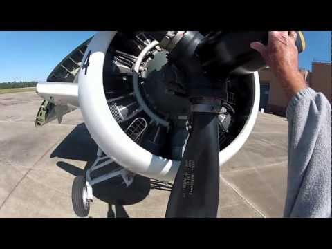

                          Thanks guys , I did a lot of browsing of photos and also found a great video that helped with a lot of the details. Its one from Kermit Weeks ,who runs the Fantasy of Flight museum in Florida with lots of flying exhibits. His enthusiasm for the aircraft is incredible and hes also made lots of youtube videos. This one is the first of a three part 'Kermie cam' video of him doing a pre flight check on his FM2 Wildcat (different engine , taller tail , minor cockpit differences to my martlet v , but everything else the same) and gave me some superb references for the wingfold, wing stays, nav lights etc . and just look at those panel joints and huge rivets on the fuselage ! most of the modern tooled recessed rivet and panel lines models are just not realistic for some of these old birds! score one for the old school !Have a look and if youve got time look at the other two videos where he takes it up for a spin all while wearing the headcam , brilliant stuff, thank god there are people like him keeping these great aircraft flying . cheers tony
