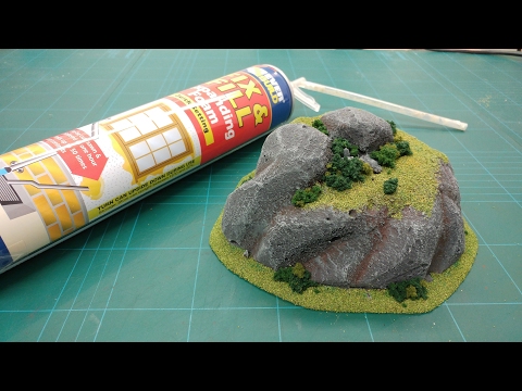

    This is another idea we got from the Terrain Tutor (link). Stylised hills/rocky outcrops for our battles - made from that expanding insulation foam you get in cans.
    Process is as follows:
    • Squirt out foam as desired.
    • Shape to your wishes and glue to a base.
    • Cover in polyfiller and grit to your taste.
    • Paint using kids or household paints - a base coat of dark grey following by 3 coats of dry brushing 3 different shades and colours.
    • Add flock and foliage to your taste.
    • Job done!

    How The Terrain Tutor does it
    Junior squirting out and the result once set:
    [ATTACH]356050[/ATTACH]
    [ATTACH]356052[/ATTACH]

          Should you ever get around to trying it, in terms of using it, this is what I've learnt to far:
          • Cutting. Very easy to cut. Use a serrated knife though. Nothing fancy, kitchen knives are fine (mine are well over a decade old). The slope on the track was cut with a bread knife. Virtually no dust.
          • Sanding. Do it outside - HUGE amount of dust!!
          • Glue. Hot glue gun all the way. PVA does work but takes forever to dry.
          • Filler. Cheap stuff is fine. Use standard grade. The thick deep crack stuff it a bit hard to work and the thin fine crack stuff is not heavy enough.
          • Filler finish. Do not try and get a perfect finish on the first attempt. wait for it to partially set e.g. 15-30 minutes and go over it with very wet finger to smooth it down. You will get a much better finish and it will be less messy.
          • Grit. Having smoothed the filler down with a very wet finger it should be very damp (if not small pools of water forming). Now is the best time to grit, as it will sink in slightly and the filler will really grip it. It also saves having to wait for it to dry and then PVA it and wait for that to dry.
