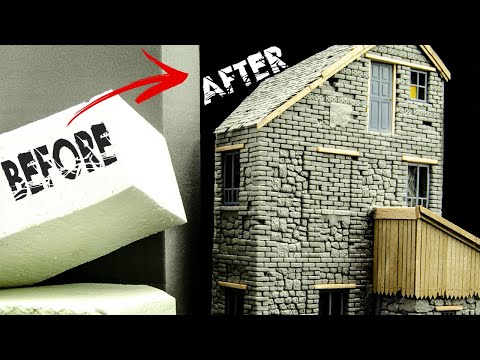

          Styrofoam is a quality product that can be sculpted and manipulated to create buildings and there are many YouTube vids on the tinterweb that show what a versatile modelling material it is. In the right hands there are many amazing creations out there. Foamboard is another product that many use to frame scale buildings
