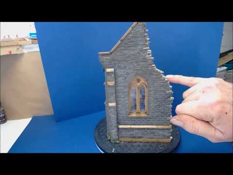

                              Any idea how the end effect was achieved in the video below? The first wall finish would be perfect and exactly what I would like to achieve. Done with the same mould and also casted with plaster in buff. This is all the useful info I could get from the video. Unfortunately the creator stopped being active on youtube.
                              I have been also thinking about priming the walls with acrylic medium - would that make the washes work for the other buildings that I did not ruin yet?
                              https://www.therange.co.uk/arts-and-...=402436#402436
                              I will try to paint dark te crevieces on the bridge with a tiny brush, then use half dry brush with ivory paint and then add some patches to make it look less uniform. Hopefully I will be able to salvage it.
