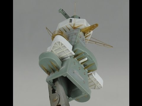

                            I also use PVA for sealing small gaps between vertical surfaces. Here's a link to a video showing how:
                            Gern
                            PS That's not me in the video! I'd give my left arm up to the elbow for modelling skills like this guy!
