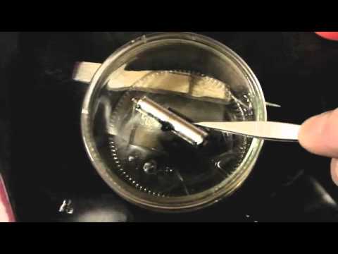

            I strip chrome using generic household bleach.
            Strips most platings in seconds, some older brands take an hour or two if the plating is very thick, very cheap for a large bottle, same can be kept in a container and re-used many times before it's effectiveness is compromised, very little permeating odour and a quick rinse under running water to clean afterwards.
            [video=youtube_share;GaXuYX6bv2M]
