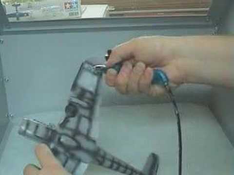

                    I like pre-shading; the key is thin coats. Check out Brett Green's tutorial videos on youtube.

                            Originally posted by \
                            Now, the thing is, (and admittedly it may be the poor compression quality of that video), but the end result looks to me like the end result I got which amounts to barely showing through to degree that the time spent doing this seems pointless.
                            I know Brett Green is a well respected modeller and has written and produced plenty and i'm not trying to rubbish him, just my thoughts on the video shown.

                              If i'm honest i think he painted over the preshade far too much. But he's the 'expert' lol
