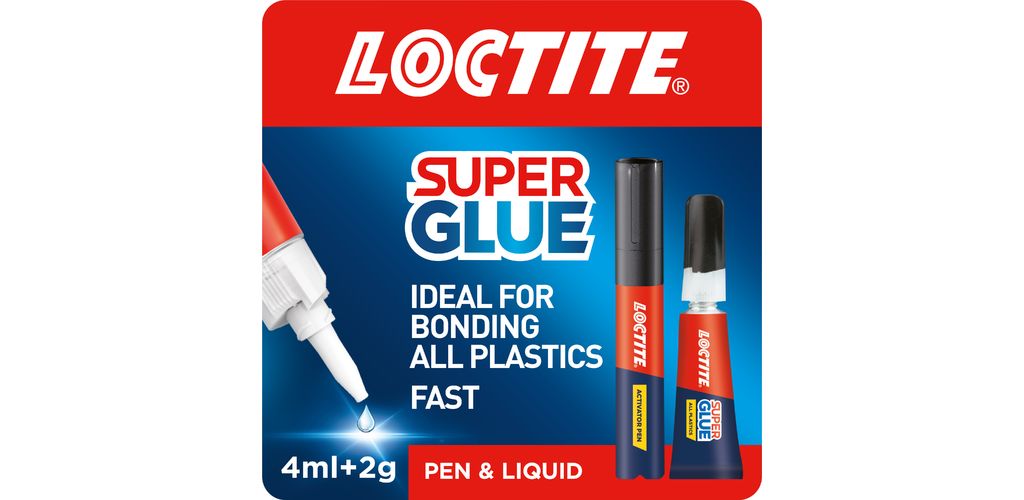

                  I know some rubber band tracks stick with styrene glue these days, perhaps these do?
                  Only if it tells you to glue them in the instructions. If those say to melt the pins with a heated screwdriver, glue isn’t going to work very well.
                  Failing that, how about CA glue?
                  You will need to have the kind that comes with a kind of marking pen that you need to “paint” the plastic with first, like this:
                  I’ve not used this one by Loctite, but I have used similar superglue from Pattex, which isn’t available in the UK. However, Loctite and Pattex are both brand names of Henkel, so I suppose the actual glue and pen are identical. Also, when the glue from this package runs out, don’t throw away the pen — it will work with other superglue too. Be sure to follow the instructions, though.
                      That stuff is excellent Jakko. I've not used it for modelling but for several household repairs, and it's produced a bond at least as strong as the original plastic.

                          Thanks guys. I've ordered some of that Loctite Superglue. I'll give that a try with PJ as I'm not at all confident with the heated screwdriver method - and PJ is even less confident than me!
                            #28
                            Good luck — though let me repeat: follow the instructions If you don’t, the bond won’t be much stronger than when using just superglue.

                                PS That Loctite CA worked a treat on the tracks!
