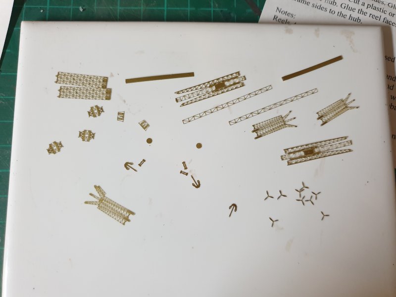

                      Returning to the modelling, I have been through the photo etch and removed the parts that I will need:

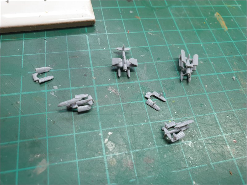

                              Construction of four seaplanes was very fiddly and took a long time to get them all done. Unfortunately, one of the side floats on the Nakajima E8N went for a flight test never to be seen again so I have done a bodge job on a replacement. That particular plane will sit inside the lift:
                              The Photo etch propellers were glued to the front of the engines and this photo shows the second plane's propeller is out of alignment. It has since been removed and refitted in the correct place:
                              PE bracing was added each side of the platform covering the aircraft service area. The PE instructions said to add two more smaller lengths of bracing fore and aft of the platform but strangely, there was only one piece of bracing left and it was the wrong length so I left it off. The four platform supports were glued to the underside of the platform but dry-fitted to the deck so ensuring that the supports were aligned correctly. That should prevent some grief when permanently fitting the platform later on in the build:

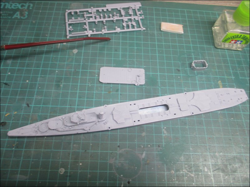

                              The foc'sle and quarterdeck were glued in place after a bit of fettling at the bow:
                              I dry-fitted the other deck sections and their fit is pretty good which should (hopefully) bode well when I eventually glue them:
