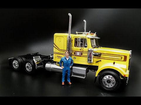

              Andy this guy is really good at explaining these truck kits hope this helps I would definitely move that front axle forward a bit and add some shims to build the front end up a little so it doesn’t has that “ squatty look“ in the front like most of these Models do.

                Thanks for all the info Lee, looks like I should have done more test fitting but I've been spoiled by kits that just fit.
                I'll watch the video later and fingers crossed it isn't too late.
                      I had a mild panic attack after watching the early part of that video as he's put his air tanks in a completely different place than I have!
                      I went back through the instructions and my placement looks right, and subsequent steps show them in the same place so fingers crossed it's down to his being a slightly different version.
                      Will be following your advice and putting some of the body parts together to check alignment now though. Especially since even the box art is cocking one leg :smiling5:

                        #26
                        I know you have the bigger sleeper version of the one I sent you but I still think the front end is still the same I got these pics for you as reference only so you can see how it sits low in the front and the wheels are to far back as well as they hang out side of the fenders instead of being tucked underneath the fenders instead hope this helps. I’ll be glad to help you in anyway if I can as a 4th generation trucker and built many of these models I hope you can trust me lol. Click image for larger version
