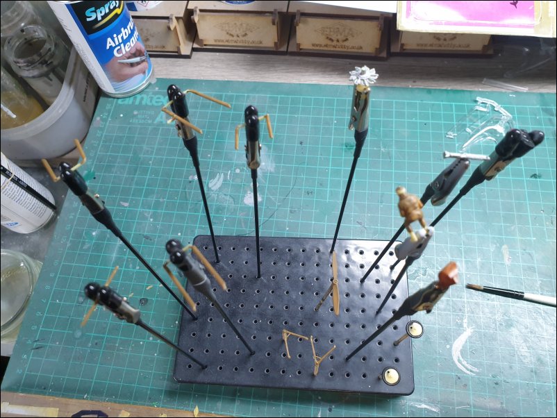

            The inside of the fuselage halves and lower wing centre box have been painted with H74 Matt Linen:
            The struts, pilot, seat, gun, instrument panel, propeller and tyres have been painted:

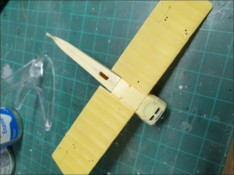

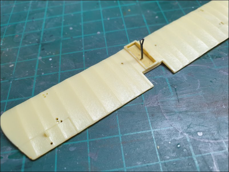

                            Another little update.
                            I attached the lower wing to the fuselage but it was necessary to cut a little plastic from the front and back of the centre section in order that the wing would sit correctly. The:
                            After filling and sanding the lower wing join, I applied the first coat of H155 Matt Olive Drab to the wings, tailplanes and fuselage. I also applied a coat of H34 Matt White to the outside of the wheel covers which will eventually be painted red, white and blue:
