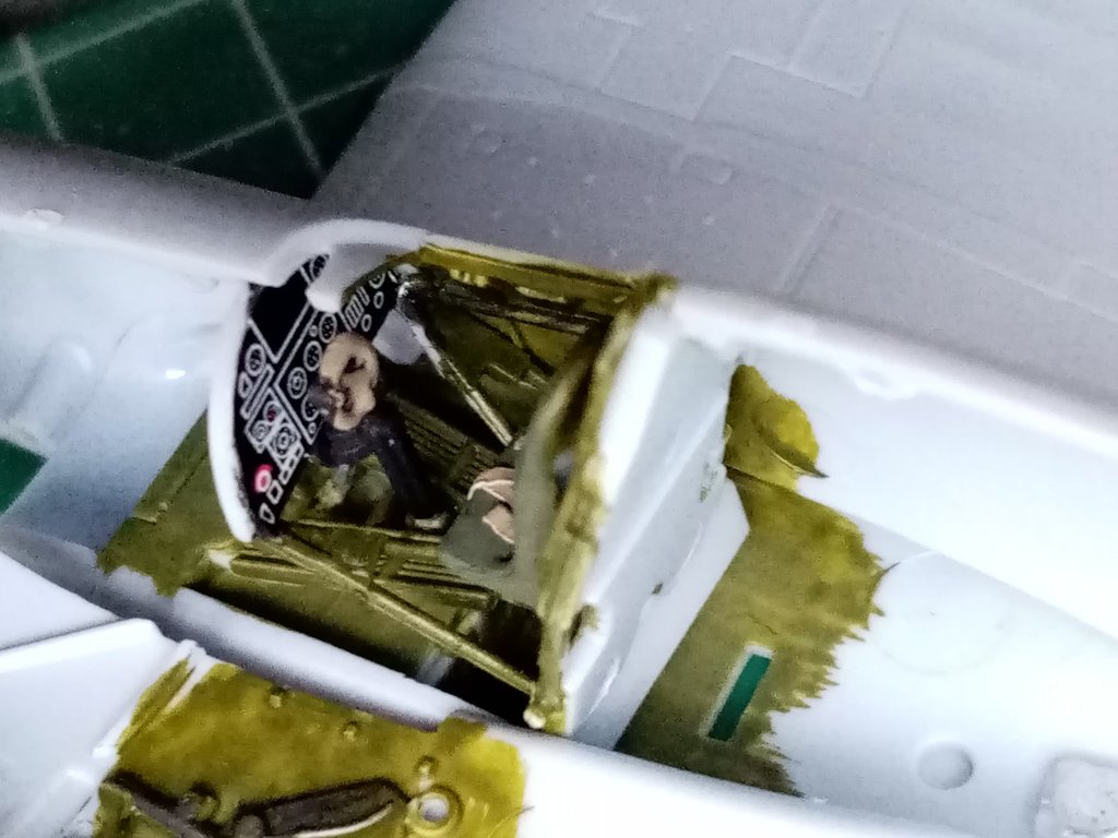

              A remarkably detailed cockpit and landing gear bays, a bit lost on me really, most of it won't be seen once the canopy is on. but I do appreciate they take the time and effort to add detail.
              I don't have WWII RAF colours in my new fangled Japanese acrylics collection so it's the trusty Humbrol enamels. masking tape seat harnesses add a bit to this well represented cockpit
              I spent a minute or two cutting away at the excess decal carrier film of the cockpit instrument panel only to find there wasn't any! Well done Cartograph! Perfect printing. Only now I see the 'interior green' needs another coat, but, it won't be seen anyway!

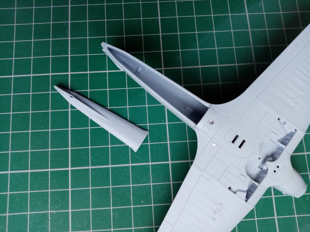

              Twelve parts in and the wing upper and lower parts go together, a good fit but the trailing edge is a bit thick.
              This is what Steve was saying about being a tight fit, I had to snip bits of the cockpit structure to get it to join with the closed up fuselage, however, the fit despite having complex curves and angles is a very good gap free fit!
              Not sure why Airfix when for assembly of fuselage 'thirds'? But, it fits well so can't complain.

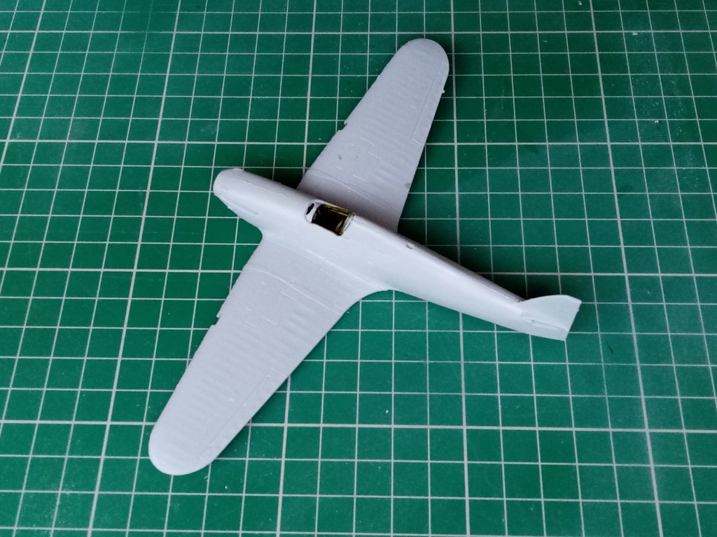

              Time to assemble the empennage and then primer paint!

                    Primer coat on. . . . the canopy fit was one of the best fitting two part transparencies I've know! Well done Airfix
