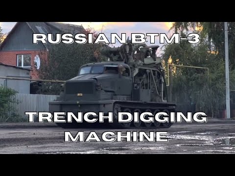

        The dirt was flung out to either side by two powered rotors ( garden swing seat thingie )
        [ATTACH=CONFIG]n1188341[/ATTACH]
        Doesn't answer the question of how the spoil was removed if the soil was dry & sandy - probably another of the limitations of this thing!
        It also begs the question of how those buckets would pick up loose sandy soil with just some chain at the back. I wonder if Dave's idea of those being added in the field and other alternatives were available depending on the terrain?

            Are they actually supposed to pick up the spoil though Dave? They may be designed to simply break up the ground so it is loose enough that the plough arrangement at the back can push it up and aside, so forming the trench and parapet?
                I'd thought that, Tim, but surely the plough would be angled to either side from the centre? Watching the videos doesn't really help, there's too much drt flying around!
                  #23
                  It seems to work well enough in dry soil:
                  I’m more wondering what it would do in heavy, wet clay now
                  Aha, you can sort of work out how it works in this video, from where it starts here if you hit play:
                  The chains are much longer than I had the impression: I thought they formed a sort of mesh floor to the buckets, but they actually make a much larger “pocket” that retains the soil until they get to the top part, where the soil then falls out so it can be kicked to the sides by the rotor thingies.
                      Looks like Jakko has aced it with those videos Dave. The “plough” obviously just keeps the depth consistent. Still think a straight line isn’t ideal for a defensive trench though, it needs zig zags……Wonder what the wear rate on the various components is as well :tongue-out3:
