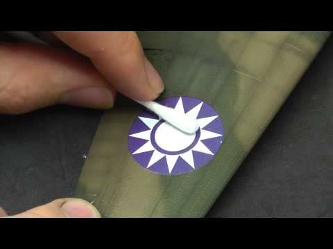

            There’s a wealth of information I’ve videos on YouTube, I found this one to be quite helpful -
