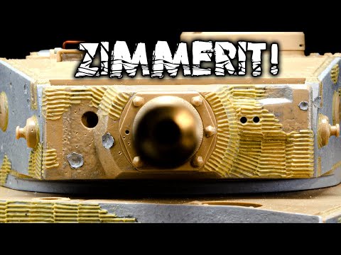

    I will be shortly starting my big tiger I am just wondering what to use for zimmerit as I the tools included in the kit any help would be most appreciated

    Hi Peter
    Have a look at nightshift on Youtube. He does a excellent video on zimm and its on a Tiger
    Bob
      I like to use a thin layer of putty (from a tube) textured with a saw blade. Work on small areas at a time, because the putty is likely to dry before you get to the end on larger areas, like a hull side.

        I used to use Tamiya two part putty.........little longer working life and went on real smooth. Haven't seen it for years, does anyone know if they still make it? Rick H.

          Hi Peter
          Bob
          Somehow missed that one Bob. That is THE best technique I've seen so far. Thanks for sharing.
            Hi Rick
            Night Shift uses it for his Tiger. The build is only a year old so should still be available.
            Andrew
