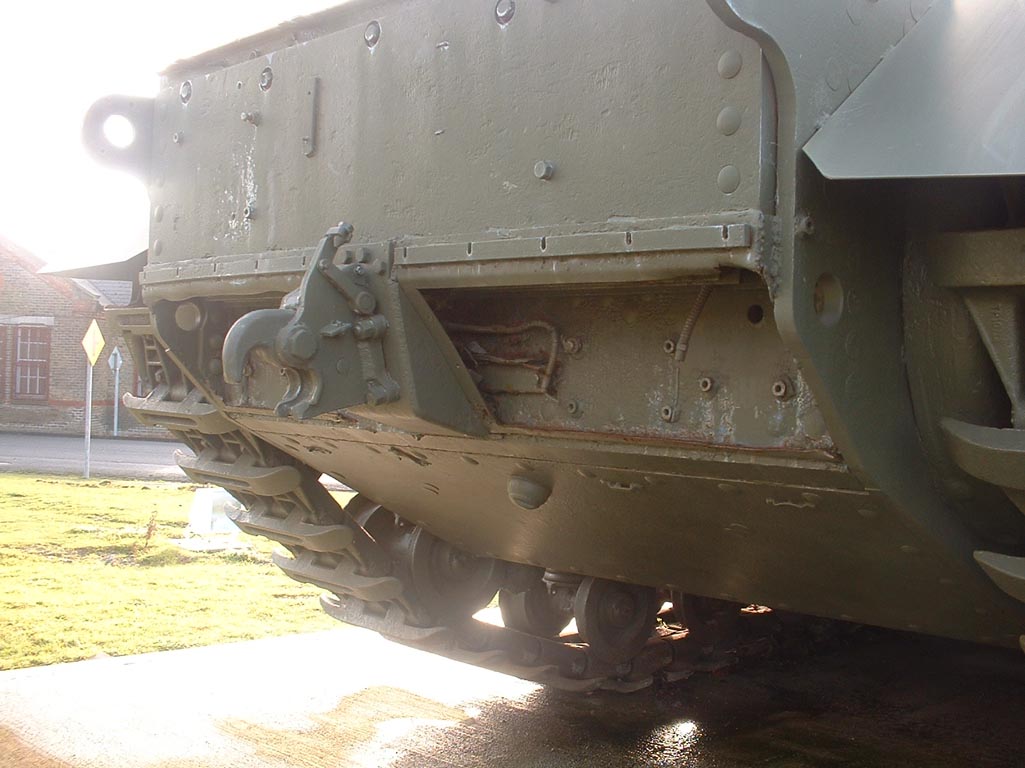

              Working on the build and I need a little advice.
              Looking at this section, there are two small box-like objects (B8) that glue onto the rear of the tank.
              These sit on two pins, however along with the two pins they sit on, there are also six other smaller pins surrounding it
              which means the boxes will not sit flush.
              My question is this, should I trim off the smaller pins so these fit flush? or am I supposed to leave a horrible gap?

                    Those boxes B8 are smoke emitters (inside each are two smoke candles that are set off electrically from inside the tank), and they look like they should sit on top of the little pins, which are most likely the lugs they bolt onto on the real tank.
                    (source)
                    So no, don’t trim them off, and yes, leave a small gap between B8 and the hull plate
