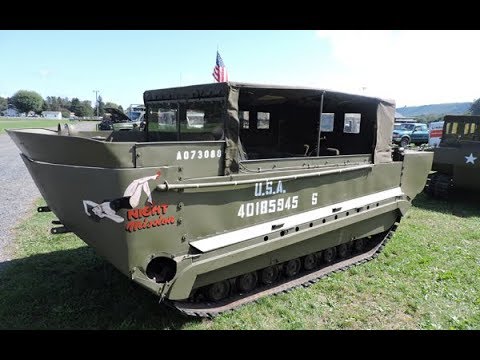

    My next model is going to be on the small side: an M29C Water Weasel, the truly amphibious variant of the M29 Weasel.
    The M29 was an improved version of the M28 over-snow vehicle, both developed for use in Norway for a Commando operation against the production of heavy water for the German nuclear weapons programme, that never actually came off the ground. The vehicles, though, proved useful for all kinds of other difficult terrain, and the M29 was developed into the M29C by the addition of floatation chambers at front and rear, plus rudders for better controllability. These could be retrofitted to existing vehicles in the field, if necessary. Though the M29C was officially known as “Water Weasel”, everyone called (and calls) both the M29 and M29C simply “Weasel”.

    Now that’s a strange looking beastie.
        It is a bit, isn’t it? Especially because of the forward-sloping line on the side, because the track at the back is higher than at the front (the M28 being the other way around, by the way).
