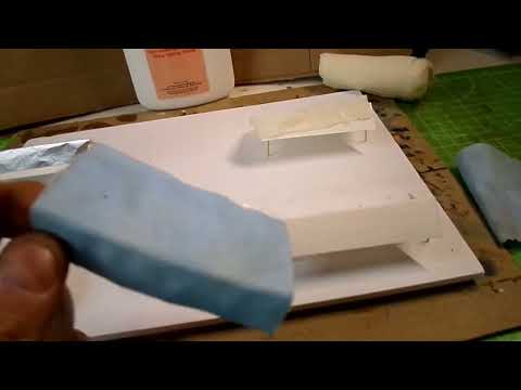

            Ok, so been busy!
            Set up a little experiment too see what works best....
            Some strong tissue, bit thicker than standard loo roll.
            A small glasses cleaning cloth.
            Some old bandage gauze.
            Some tinfoil, doubled over and edges folded over to make a crease/hem. (Also holes punched in corners).
            Click image for larger version  Name:	Model tarp exp apr25  (1).jpg Views:	0 Size:	248.1 KB ID:	1256263
            Then made some "formers" using hard but thin card, cut to size, creased into required shape, matchstick supports, then all super glued to a foam board.
            Click image for larger version  Name:	Model tarp exp apr25  (7).jpg Views:	0 Size:	256.1 KB ID:	1256264
            Gathered the materials, pva, water, clingfilm, and checked the cut samples all fit the formers....
            Click image for larger version  Name:	Model tarp exp apr25  (9).jpg Views:	0 Size:	289.5 KB ID:	1256270
            Then covered three of the formers with clingfilm as best I could, helped with bit of tape at the sides to hold in place. The tinfoil tarp does not require pva, etc, its just simply formed over the card and seems to hold its shape quite well. The tinfoil is ahead as the main contender at this point..... 8-)
            The thinking here is that the tarps once formed will maybe stick to the clingfilm, but hopefully not the card formers underneath, so can be removed and hopefully will hold their shape? we'll see......
            Click image for larger version  Name:	Model tarp exp apr25  (11).jpg Views:	0 Size:	281.4 KB ID:	1256266
            Each sample (tissue, cleaning cloth and gauze) was then placed onto each former and liberal amounts of thinned pva applied. I used a rough mix of 60% pva to 40% water so it was slightly on the thick, but still liquid side of things. As above the foil does not require pva.
            Click image for larger version  Name:	Model tarp exp apr25  (12).jpg Views:	0 Size:	290.0 KB ID:	1256267
            Here's the cleaning cloth and gauze after being coated in pva. I ended up soaking the cloth in the pva solution as just brushing it on was not penetrating the cloth that much, but by soaking it, the pva was absorbed much better.
            Click image for larger version  Name:	Model tarp exp apr25  (13).jpg Views:	0 Size:	243.0 KB ID:	1256268
            And here's the tissue and tin foil, the tissue was easily soaked and produced lots of little ripples, etc, much like when you use it to make "water", so not sure how convincing it will look as a tarp?
            Click image for larger version  Name:	Model tarp exp apr25  (14).jpg Views:	0 Size:	269.9 KB ID:	1256269
            Now just gotta wait for them to dry and hopefully set, and see whats what, will probably need at least 24 hours, and if it looks like they may need another coat of pva then I will do that, we'll see tomorrow..... 8-)

                  Uploaded to YT short video on the four model tarps (tin foil, tissue , gauze and cloth), see linky:
                  I wanted a convincing 1:35 scale tarp shelter, with two support poles and erected at an angle with a small overhang. See 1st post above.
                  The three porous materials (tissue, gauze and clot h) were coated with pva (two coats) to stiffen them up a bit so that they hold their shape, which seemed to work well.
                  I used small formers made from foam board, card and cocktails sticks to obtain the appropriate shape.
                  TBH all four methods would work ok.
                  But I think the tinfoil and the cleaning cloth worked the best out of the four.
                  Hope its useful to someone..... 8-)
