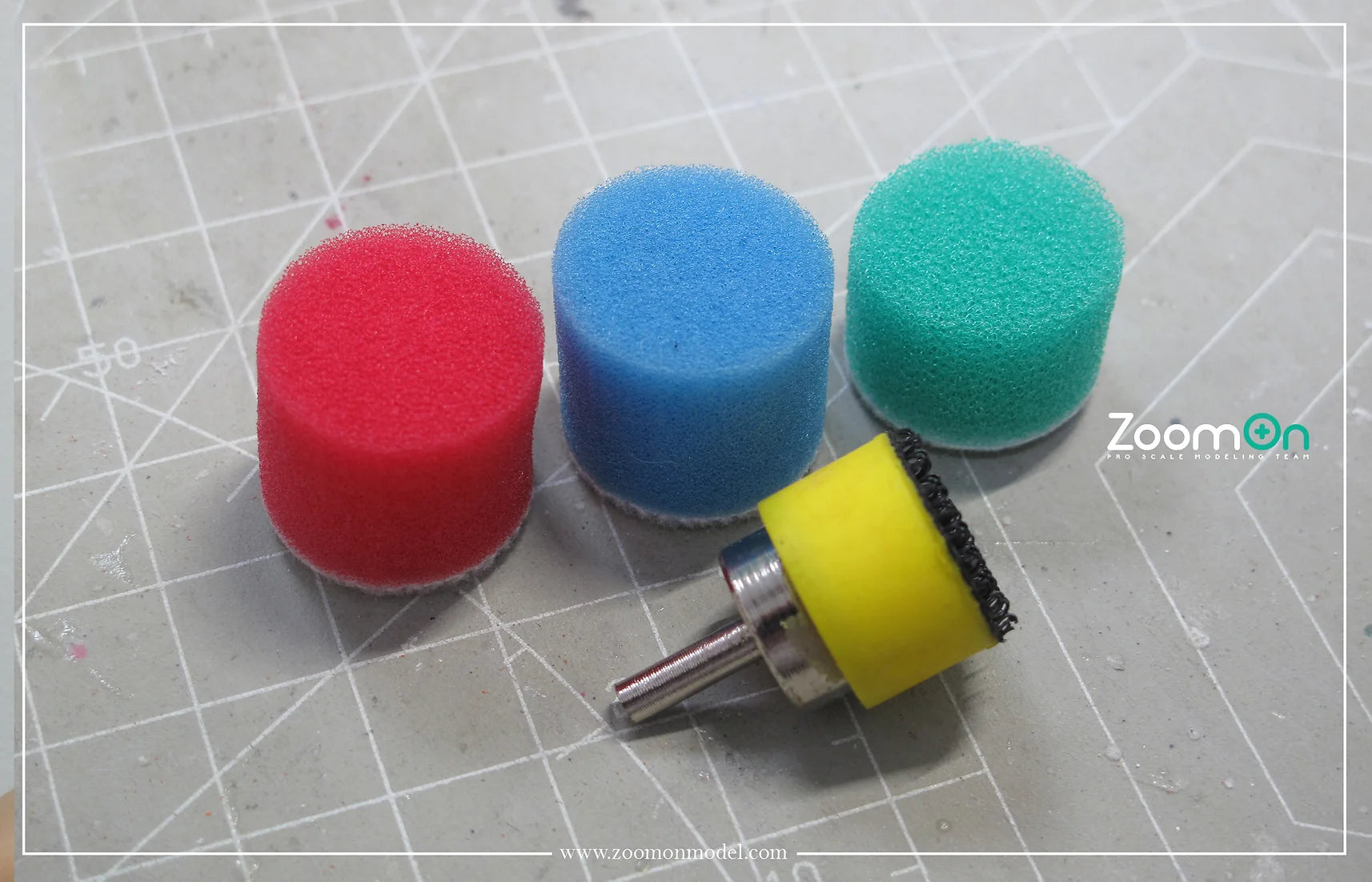

          I use the coarse and fine for car & bike bodies, never needed the finish as the other 2 get the result I need. I do power polish with a Dremel and some of these though:
          For mini electric Rotary tool use. Use with Polishing compounds and polishes of your choice.  -Coarse pad(Green) x1, Medium pad(Blue) x1,Fine pad(Red) x1, Drill x1 -3mm column fit to electric grinder. -Use water clean after use.
          Just need to be careful on edges so you don't burn through the paint.

            I will be using a dremel Bob. Now I know how you got your great paint finishes.
