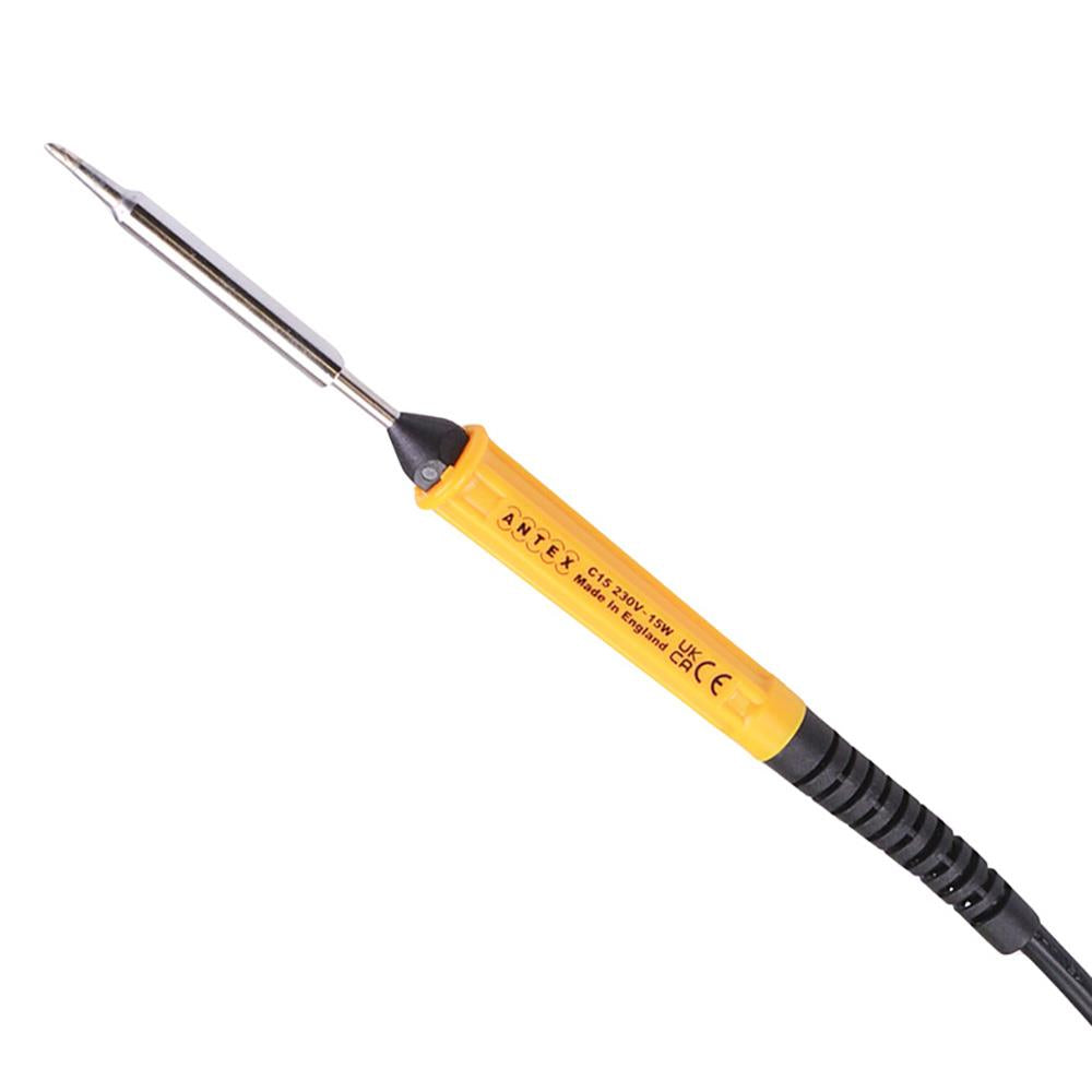

    Can I ask some questions Bob. Why temperature controlled? I never found anything I couldn’t solder with my 15 watt Antex iron with a selection of different tips. This includes soldering white metal spears into the hands of 15mm Zulu warriors with 80degC solder. The secret is very clean workpieces and the right flux and solder. I’ve never felt the need for a temperature controlled iron. would recommend 145 solder with liquid flux though, flows like melted butter….. Carrs and London Road models have a lot of hints and tips….
    The phosphoric acid flux and 145 solder will be a real game changer if you haven’t used it before….
      • 19130
      That’s the iron…..plenty of other suppliers though, this just came up first in the search engine. The tip being fitted over the element is a great feature. They don’t seize making easy changes, and the tip holds more energy due to the greater mass. The Solon type, where the tip is housed inside the element is much inferior. The tip is smaller, takes longer to heat up due to the design, and cools too quickly in use. The biggest cause of trouble during soldering is not having enough energy to transfer to the workpiece, meaning you hold the iron on too long and overheat the job. I’ve used both extensively over the years, and the Antex are like a magic wand compared to the Solon.
      The Antex C15 miniature soldering iron is ideal for lower power soldering applications including small surface mount components. The soldering iron is supplied with a long life 2.3mm tip (B082060) and features a nominal tip temperature of 410°C.1.5m PVC cableIncludes metal standNominal temperature: 410°CPower: 15WVolta

                Sorry to be a pain, I assume it doesn't come with tips?
                Can you suggest what tips are need, i don't have a clue!

                    They usually come with a medium chisel bit, but a fine point tip is always handy, and they are pretty cheap.

                          Never got on with that stuff either. Mine dried out due to lack of use 😁. My essentials list would include 145 solder, phosphoric acid flux (not the paste stuff, that’s horrible to wash off before painting and can leave burnt crud all over the workpiece), a 15watt Antex iron, an additional fine conical tip, and a decent stand. In addition, an old brush to put the flux on, and a scrap of MDF to protect your bench during soldering, would be very useful. This is the sort of stand I have…..
