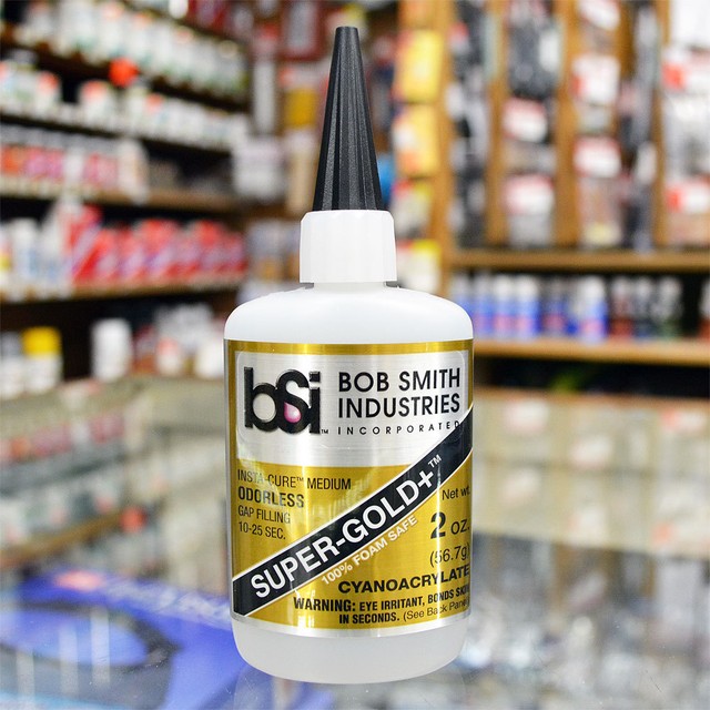

                Use Bob Smith Industries Super-Gold+. A super glue designed specifically for Clear plastic.
                See in the video below at 3:09 he uses it on the windscreen. This channel has many videos in which he uses this glue. Best fast drying glue for canopies.
                Here is the official website description
                Super-Gold+™ is foam-safe, odorless super glue. Super glues can produce fumes that can be irritating to the eyes and nose. While not toxic, some people can become sensitized to these fumes. Super-Gold+™ is BSI’s odorless form of Cyanoacrylate that gives the same high performance characteristics as BSI’s Insta-Cure+ without the irritating fumes. Super-Gold+ will not fog clear plastic and glass, which can occur with the use of standard Cyanoacrylates. It can also be used on all foams. The cost may be higher, but the added benefits make Super-Gold+ the best quality adhesive for the consumer

                  @Builder now that is what i'm talking about. I just bought some of the Formula 560 cannopy glue as previously mentioned but, now you tell me about this one I think i'm going to have to try Super Gold out too. I would never have found this had i not asked the question on here.

                      This is just a quick update to say i have tried both the Bob Smith Industries Super Gold + and the Formula 560 and the Super-Gold + is a clear winner for me (pun intended) The Super-Gold + is a gap filling adhesive which really does dry clear in 20 seconds. I've found it useful for filling in very small gaps too and once completely dry it sands down well. It's expensive at around £9 for 1/2 ounce but I think I will be using this one a lot now. I highly recommend it
