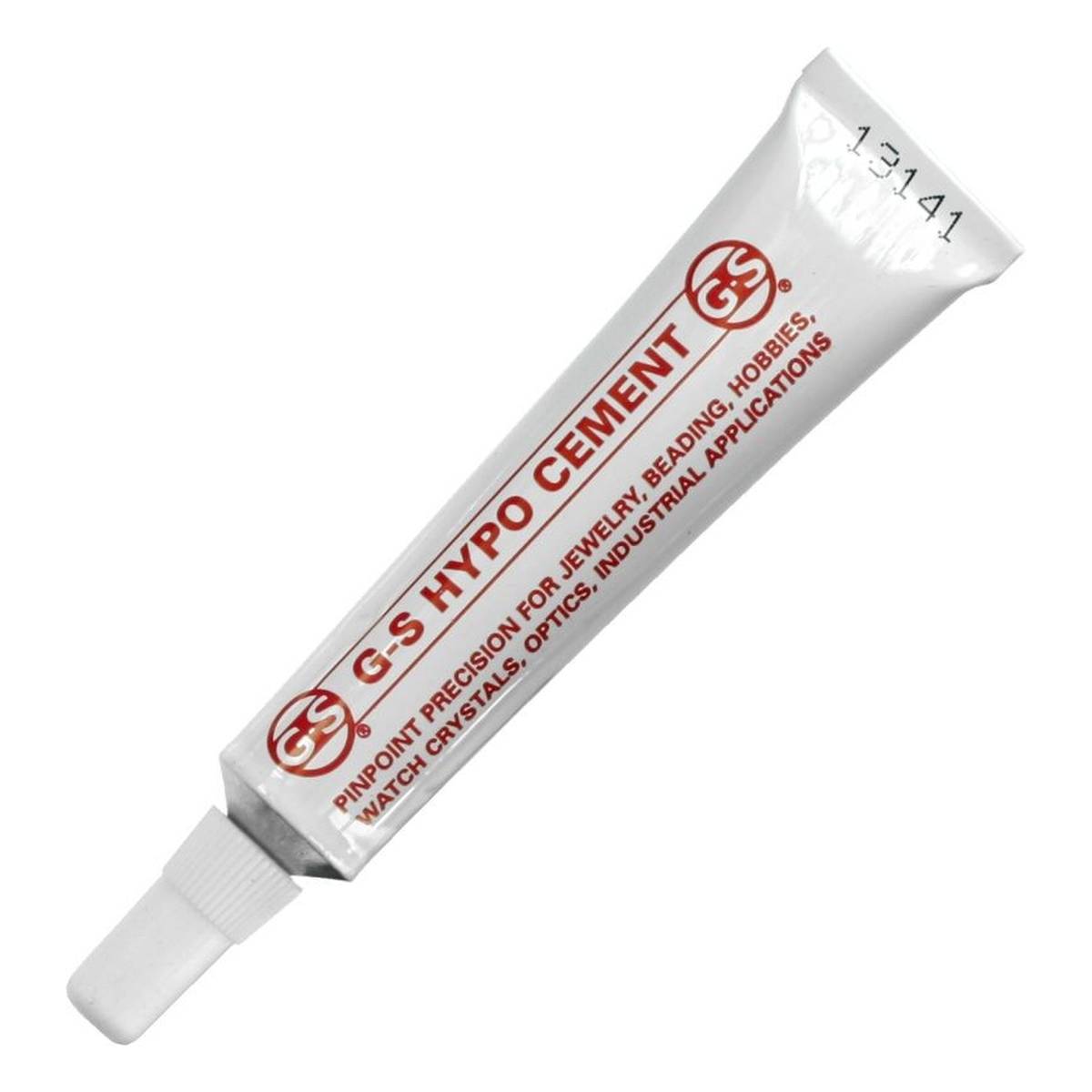

                            I use this stuff from Hobbycraft
                            Tom
