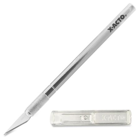

        A good knife. There’s nothing more important to have than that in this hobby. I prefer the X-Acto style:
        With a couple of different blade shapes (triangular like here for general work, rounded is useful for scraping under some circumstances, and a chisel blade to remove detail).
