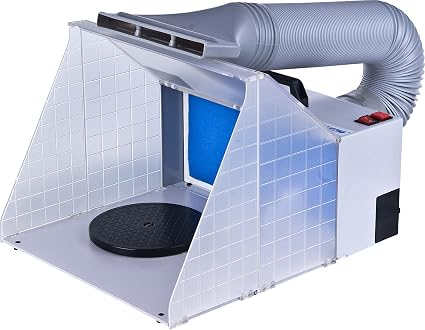

                          Working in a kitchen then fan duct out of the window. This is a nice kit. Probably take a couple of minutes
                          or more to erect & dismantle. Or leave erect if you have a space to store that way.

                            There's an advert that appears on my screen at the bottom of that post, and it's pretty much the same as what I have
                            Picked it up at an auction for about £20 I think, it's not bad for what it is :thumb2:
                              Matt that is a bargain they cost about £75. A nice unit.
