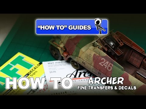

                        About 4:30 in to the second video he stated very clearly that ALL the products have an unconditional guarantee. NO MATTER WHAT. Send them a mail and they will probably replace them.
                        He also mentions that if they dont stick they are probably old OR have bad glue.....

                          This was the video that prompted me to email them yesterday. They are a good company so I should be okay. I just hope I get a replacement not a refund. Thanks for your message of help
