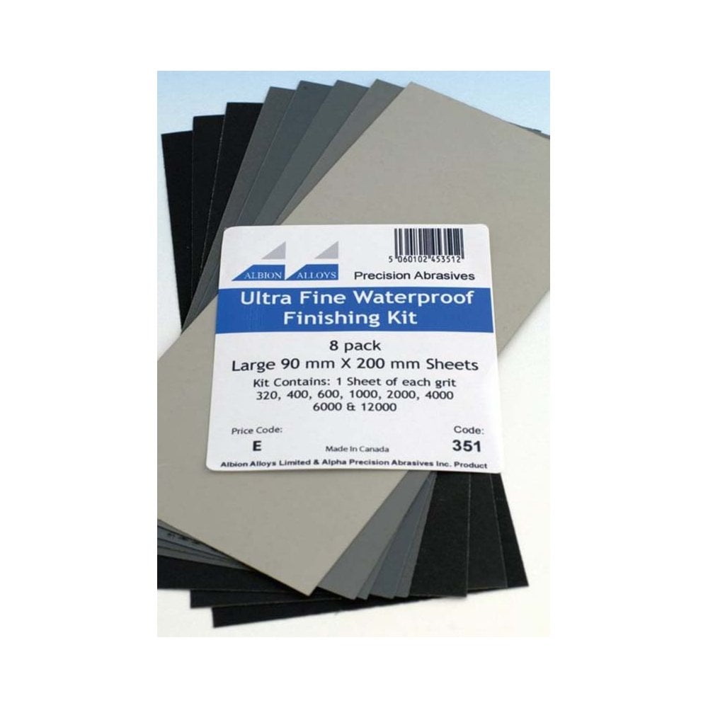

          These are good for aircraft.....the finest can be used on canopies to bring back the finish......use them wet and they last for years....
          Shop Albion Alloys Ultra Fine Waterproof Finishing Kit 351 including paints, weathering effects, tools, and accessories for scale modelling. High-quality products trusted by hobbyists worldwide. Fast UK delivery.
