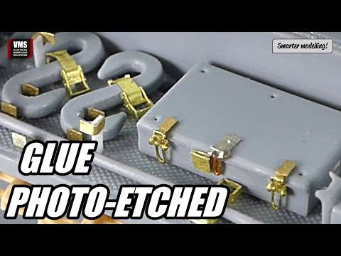

      Scottie is our resident bling master but I think he uses black magic and voodoo to attach his PE bits :smiling5:
      I have my eye on this stuff next time I run out.

        Hi Andrew
        I like the stuff which is in Si's video. It is thin so flows well into joints and has a slightly longer setting time than most thin CAs. Available from the SMS HERE

          Thanks for the tips guys. The 5K stuff looks perfect. Thin and strong but with a reasonable setting time - a few I had seen left no time for adjustments in the event of dodgy placement. I actually have a large stash of metal mince pie cups for CA the purpose already!
          And Si I see what you mean Scottie - he clearly has sold his soul to the modelling gods!! It was a very good video though. It is only though my second favourite glue video!! When I first discovered the terrain tutor I spent 45 minutes watching a video on PVA (HERE) and learnt a lot in the process. Sad but true!!
