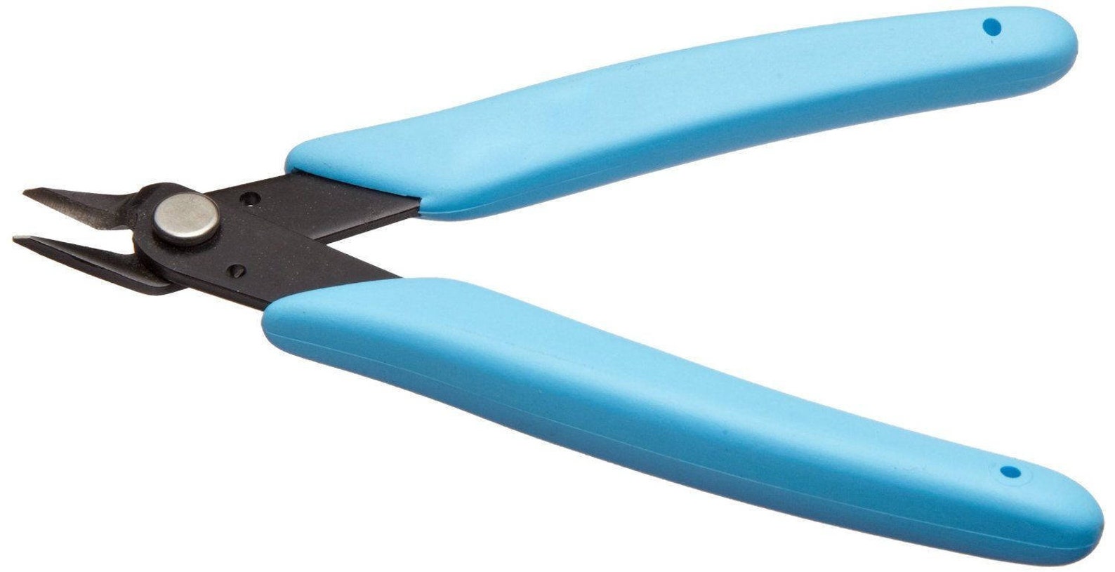

                      For most parts, good-quality, sharp cutters will work just fine, such as ones sold for jewelry making or electronics work. Something like these, for example:
                      Small parts you can cut off with a hobby knife, but hold your finger on them to prevent them flying off into oblivion. Delicate parts are likely to be damaged by either of these methods, and then a fine-toothed saw as recommended above will come in very handy.
                      You can remove the stubs from the plastic with a sharp knife, file and/or sandpaper, whichever suits your preference — I usually use a knife to cut it away, then trim and scrape it flat.
