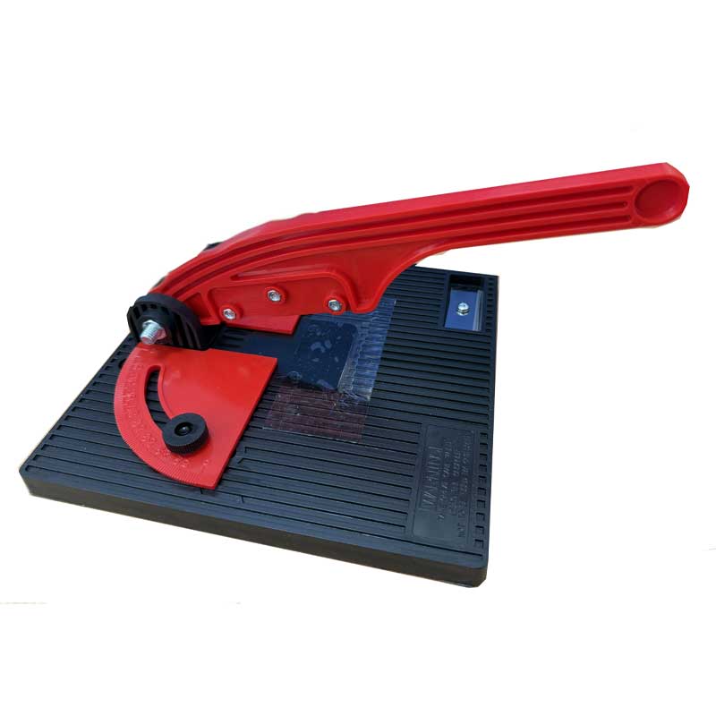

                              I use one of these for thin stuff up to about 0.25mm. Not tried it with anything thicker myself, but could be worth trying. Not desperately expensive, you could probably find one for about £15.
