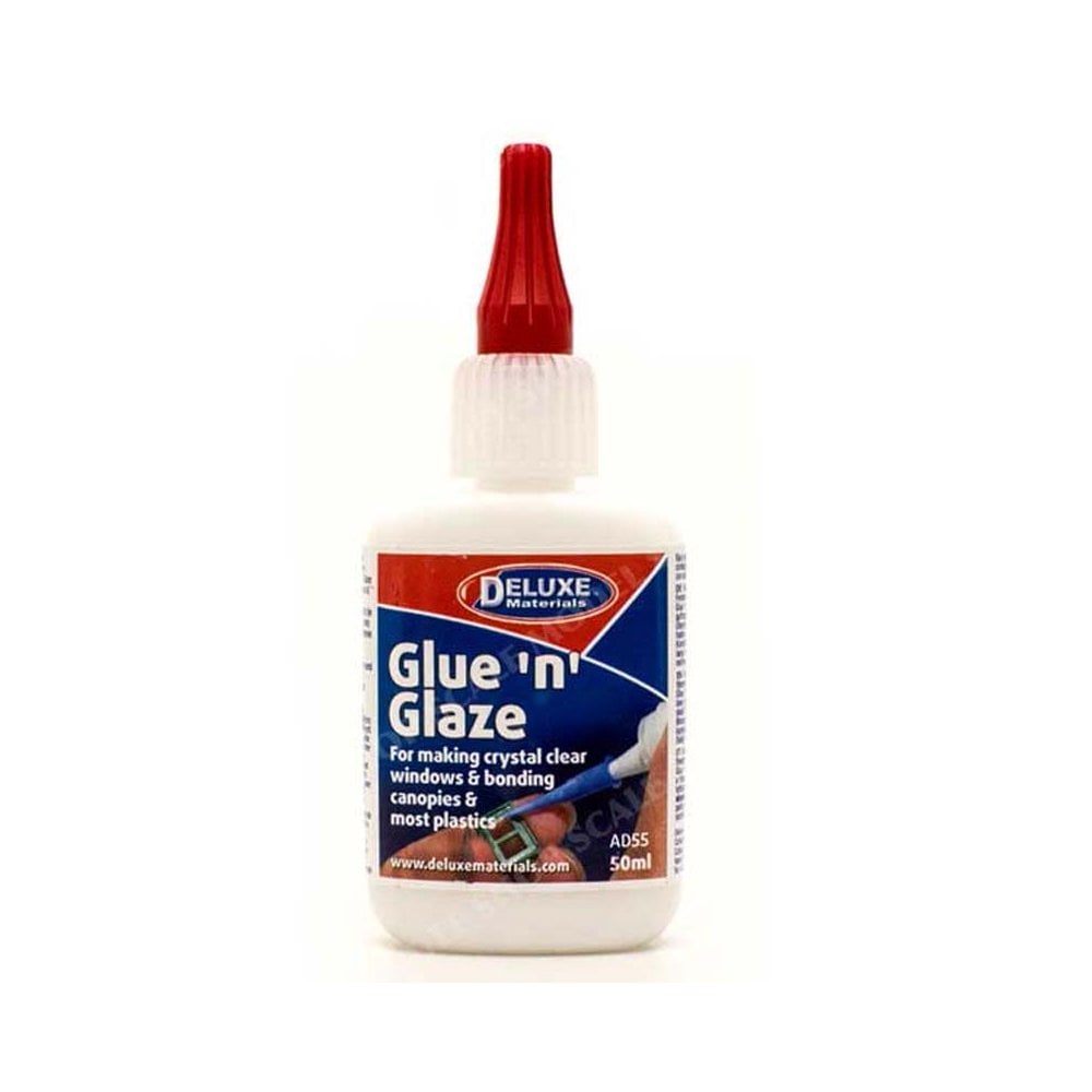

    Silly question, but tis been a long time. The time has come to fix the windows into my kit. Simple. But! The locations they have to fit have been sprayed with acrylic. In days of yor I would have scraped off the paint around the windows, Put a blob of cement down and stick in place.
    With acrylic, do I need to scrape off the paint or will it accept the glue, (Tamiya thin), then offer the window to its location?
    Basic I know but I'd rather appear dim than cock up!!

    Hi Doug
    No scraping need.
    I use a special modelling window glue as below. Other brands are available but from what I gather they're not much more than a specialist PVA. Some people just use PVA......
    Others may be able to offer other ideas.
    ATB.
    Andrew

      You might be safer using something like pva if you don't have a specific canopy glue.
      TET certainly works but it can have a tendency to run where you don't want it to on clear parts and can even "fog" them unless you're uber careful

          Thanks Andrew.

            And with some of those, you also have to be careful. Humbrol’s, for example, won’t fog or craze clear parts but will dissolve dried acrylic paint — so if you’re not careful you might end up with a smear of paint on the window instead (he says from experience).
              • 16174
              Lots of special glues around but PVA does work. It doesn't fog the clear part and dries clear. Also any smears are easily cleaned up with a brush dampened with water.
              One thing to be aware of is the bond is not that strong so don't press too hard if later you're masking the clear parts. Once you've pushed a window inside a model it can be a b****r to retrieve. I still have a model that has a rattle :rolling:

                  How about superglue? Is that any good or does it react to plastic?
                    • 16174
                    Some say the fumes from CA can cause fogging. What I've done successfully is fit the window/canopy with PVA and then very carefully wick thin CA into the join in a few places. I use a thin piece of wire to dip into the CA and pick up just a tiny amount and touch it to the join. The glue will wick into and along the join.

                          I use Pacer's Zap Formula 560 Canopy Glue PT56 for fixing canopies, windows, lights etc. It is similar to PVA but is of a thinner consistency.

                            I use G-S Hypo Cement. It has a gel like consistency and a needle applicator making it easy to keep away from areas where it's not wanted. It makes a very strong bond. A tube will last for a very long time.
                            It will not fog clear parts and dries clear itself.
