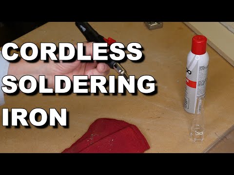

                Thanks Gentlemen, I now have an idea of what to expect when I try using these various products. I wasn't sure about the decal setting solution as it was a little "milky" looking and is that normal? All the other setting solutions I have had experience with were clear. Here's the next mysterious item ....it came with no paper work or other information....Click image for larger version

                    Looks like a gas powered soldering iron.
                    • Andy T
                      • Apr 2021
                      • 3239
                      • Sheffield
                      Looks like a gas soldering iron. Portasol is the big name there, this appears to be a copy of that
                      Edit: Oops, slightly too slow
                        • 19104
                        Like this one….
                        Find many great new & used options and get the best deals for Schneider Cordless Soldering Iron Micro Torch Hot Blower 64034 at the best online prices at eBay! Free shipping for many products!
                          • 19104
                          ….and here’s a vid on how to use it…..
                            There you are Rick, no need for me to say anything other than love the TET .
