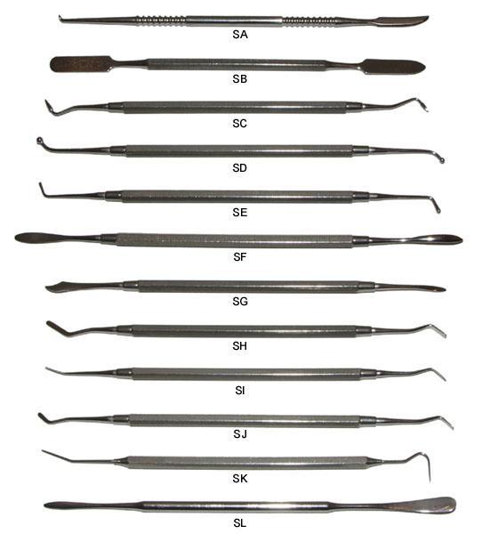

        I have a bunch of dental/sculpting tools, of which there are a few I use a lot to apply filler with. I don’t have exactly these (because I bought them all separately over many years), but they will serve to illustrate:
        Most of the time, I use ones similar to the SB, SJ and SL types.
          Thanks Jakko, appreciated
                  Do you offer dental work as well ?
                    I use a tooth pick , and a metal one as Jakko's post SF. With the deluxe filler a damp cotton swab to clean the surrounding area is helpful Bob.
