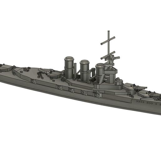

                            https://www.myminifactory.com/object...er-1913-200273
                            The GrabCAD Library offers millions of free CAD designs, CAD files, and 3D models. Join the GrabCAD Community today to gain access and download!
                            This is my version of the HMS Tiger UK Battlecruiser from 1913, designed as a 1/200 scale 2 Channel R/C controlled model. The primary reason for the design was to test the possibility of making model ship hulls from 3D printer parts. The model hull has been printed, assembled, as can be seen from the images, tested and performance is above expectations. The detail has been kept simple but more can be added if required.
                            1 2400 scale model of the HMS Tiger, battlecruiser for the British Royal Navy. Multi-part model, turrets, masts and cranes come on seperate sprues from the Hull. Also optional turret design with the gun barrels at rest

                              Gary, thanks for those - I'd seen two of them - but "this model is designed in the 1/1800 scale but can be printed in 1/2400 scale without appreciable loss of detail. " - Bumping it up to 1/700 wouldn't look too good. Similarly the others are designed to be printed at 1/2400 - the GrabCad site requires you to register as an active working designer to access the files- I get enough spam emails & sales calls as it is! I'm still looking - you can but hope!, after all the Queen Mary was a 1/1500 scale model, but was good enough to enlarge ( apart from the turrets )
