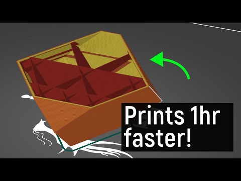

          Dave may be of interest , some settings to alter
            #110
            Gary,
            thanks - I'd seen this one, and tried some of the suggestions, whilst they do work there is always some form of trade off - if you're printing to a tight schedule, fair enough. but for myself, I can live with it - my machine produces better prints, at slower printing rates, and I don't have any deadlines!
