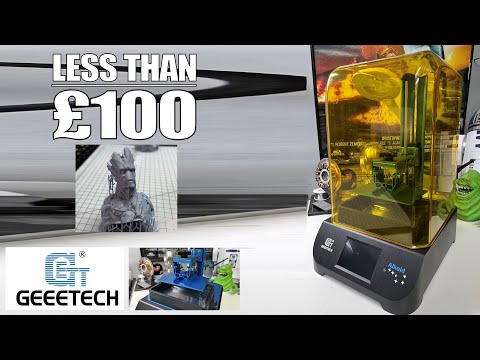

            as an aside
            Theres a very cheap and very capable resin printer getting good reviews , one such review @
            If you go to the link he provides the resin printer is

            They are temporararily out of stock in UK , but a 2k resin printer plus a wash/cure station package at just over £200 is well below any other manufacturers package deals.

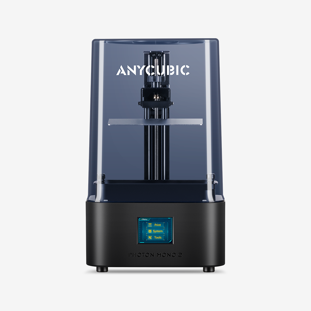

                          Sorry to jump in but I see Anycubic have their Photon mono 2 on sale at £149. £228 with the wash & cure 2.
                          Seems like a bargain for a branded 4k set up but with resolutions getting finer all the time is it worth paying extra for 8k, or even their new 12k machines?
                          Without seeing prints from the various machines side by side its hard to decide if the extra investment is worth it for the kind of things we're likely to make in our hobby.
                          The Anycubic Photon Mono 2 is an excellent choice for 3D printing beginners, thanks to its 6.6-inch 4K+ LCD screen and high resolution. With its user-friendly design and exceptional printing accuracy, this resin 3D printer is ideal for bringing your ideas to life..

                            At present all 12k printers ( consumer level ) use oblong pixels , so you get a resolution in x that is diferent to y
                            e.g. Elegoo Saturn 3 Ultra --- 10" ,12k , 11520 pixel by 5120 pixel , 19 x 24 microns ( oblong pixels )
                            so the orientation of a print will decide which part has the slighly lower quality ( probably impossible to see with naked eye )
                            the smaller brother printer , a Elegoo Mars 4 ultra --- 7" , 9k , 8520 x 4320 , 18 microns ( square pixels )
                            If you can handle using a smaller build plate the Mars 4 9k has a better resolution than the Saturn 12k , and should produce better output.
                            There are lots of reviews on Youtube that go into details further than this.
                            The alkaid i linked in a previous post is 51microns.
