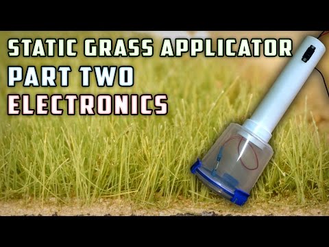

          I,,made one,use this way a bit more work,but dose work well,

              I did,but found it did not work so well,so make the one I,posted,and that works fantastic,

                            the lack of power and the closeness,you had to be was why,I made the other type,
                            but I,did see a you tube,that someone had remove a resister and make it work a lot better,
                            Originally posted by col68
                            We are just watching the link Monica put up to see if we can make 1 of them
                            Will keep updating as we go
                            Colin with I can make it,you can,and work,s so very well,
                            but for 12mm static grass,you need a mesh that is a big bigger so it can slip through,
                            so real need to lids,one for ,from 2 mm up to 6mm,then one for the taller,
