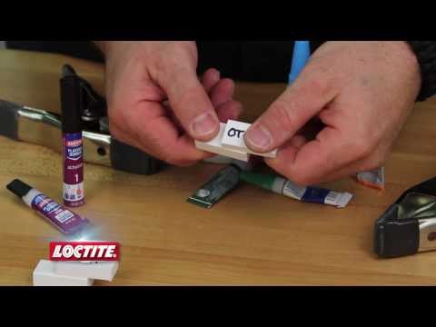

    I have been using Cyberbond Activator for some time. It is a pen pull off the top & you have a felt tip.
    It is to prime before C/A glueing ie priming not an activator after applying the C/A.
    Cyberbond are only selling these pens in 50s. Tut.
    However Loctite to the rescue. They are doing a similar product. Just used it & it works perfectly
    Especially for rigging it goes off so quickly. Just prime both parts & when dry, secs, just C/A in the normal fashion.
    At the moment it is coupled together with a tube of Loctite C/A. ie you buy both.
    [ATTACH=CONFIG]n[/ATTACH]
    These two Ytube clips give the facts.

    Laurie, that looks very good...looks like I'll be dipping into my pockets again!
    Great find!

        Hi Laurie
        Whats the number of the locktite kit? Had a look and its hard to find or no doubt me!

          I found it in Robert Dyas for £4.99.
