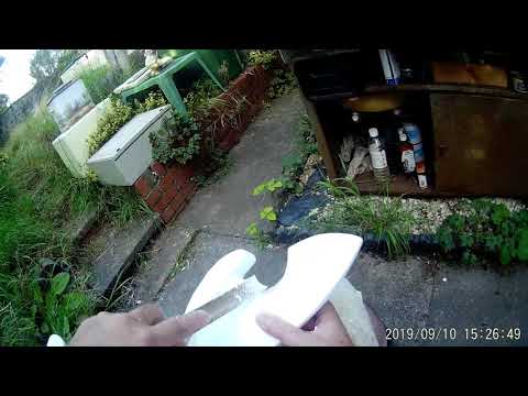

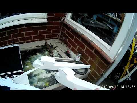

        Make a paper template first of the fuselage side view and plan view,carefully attach the template to the block of foam with silk pins and draw around the template,when the wind dies down outside I will show you how to cut the sides from the block,to do it at the moment would create a snowstorm of foam debris ! yes its a messy process but well worth the effort,standby....
