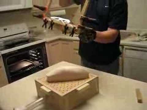

Hi All,
Just thought I would share this one with you, found this video today which shows how easy it is to make a Vac Former very similar to the one I have described here.
Make a Vacuum Former! Video - Metacafe There is a quick advert in the middle but keep watching past that.
This guy is a regular contributor to this site and makes some cool gadgets.
Enjoy !!
Regards..........Mark.Comment

Just a few lines Made a vac set up last year used a large stainless steel terminal box scavinged from scrap bin. Spent a long time drilling 1mm holes @ 10mm centres in a square of 12mm MDF which is secured to term box using pan heads in counter bored hole and a rubber gasket between the two . Vac entry via the original cable entry points enlarged and fitted with MDF to 'snug' up the pipe have a wet 'n' dry workshop vac which works well,For heating use a small electric oven/grill I got from Wilkinsons for £10.Frames from Hobbycraft designed for use with embriodery/cross point make ideal frames for holding plastic sheet for heating and forming. Will post some picies if any one interestedComment

Been reading through this thread tonight and wondering how many people have taken the plunge with one of these devices.
I enjoy flying R/C heli's amongst a lot of other models and am currently working on a couple of nice scale fuselages. It is nice to have all the usual lumps and bumps on them too (radar/antennae/camera housings etc) having looked at the vario site, they cost £20 upwards for a very simple basic lump moulding....now you know why I have a vac former !!
Regards......MarkComment

If you check my original pics at the start of this article - you can fit a divider frame on the top to allow use of smaller pieces of plastic for moulding small parts. If they are really tiny parts, best forget this machine and just plunge mould your part. A lot less time consuming.Originally posted by \Looks easy enough to do. A little more reading I think is needed. Just need a small one to make a few canopies for a future project. Saying that I have worked on some bigger vacuum presses (40ft x 10ft).
