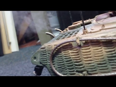

      That was a interesting video Terry. Of course I was hoping for some real combustion resulting in flames .:disappointed2:
        UH OH he's off again YOU cant have flames John as the poor ole tank or ship would go up in flames lol but then i :thinking: suppose you be happy lol:rolling::thinking::flushed::smiling::smiling2::smiling3: but too make you happy John i wish i had took a pic of my model room hover as that did go up in flames but sorry no pics lol
          Wait for the blooper reel!!!! :smiling:

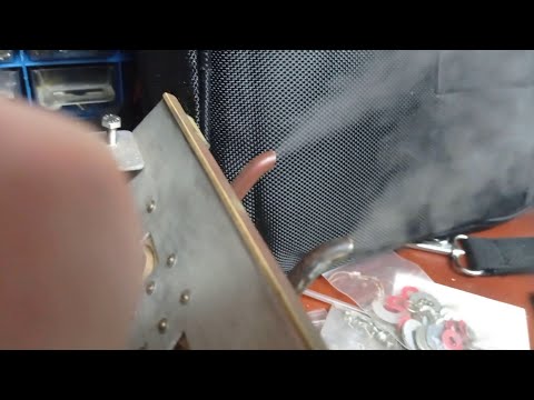

            AH HA after about 3mins the vid is now working cheers for that Ian now i'll see whats goin on an it looks like Terry is usein a pipe cleaner isnt he ? an dropping smoke oil onto the heated pipe cleaner am i right ?
            No mate , whatever you do do not use the pipe cleaner as an element it will melt!! the pipe cleaners were used to soak up the oil then wrapped around nichrome wire

              Get ready gang...i have made a monster!!!
                #22
                That's so realistic Terry. Well done .:thumb2:

                    update...its a bit messy, had to rush it due to busy mothers day- I had to cook!!!!
