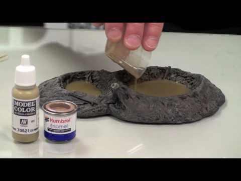

                I have no experience whatsoever with water effects, however, I youtube a bit and this was in my recommended videos when I went on a couple of days ago and have to say it looks excellent.
                It's called magic water, is a two part resin and I have no idea who makes it.
                But I hope this is useful.
